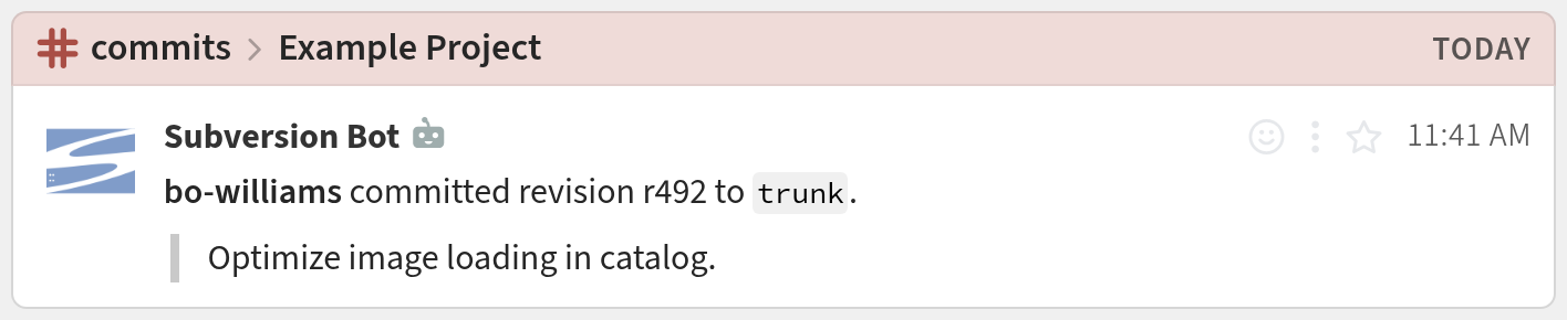

You're done! Your Subversion notifications may look like this:
SVN commit bot message
