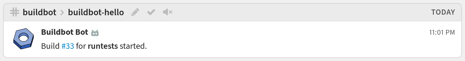

You're done! Your Buildbot notifications may look like this:
